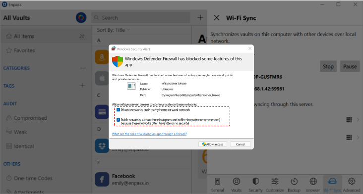

If you’re using the built-in Defender on your Windows system
The visibility of the Enpass Wi-Fi Sync Server depends on the network type (private or public) and Windows Defender Firewall settings. When you start the Wi-Fi Sync Server, the Windows Defender Firewall blocks it until you specify the types of networks it should be allowed to communicate over.
![window defender firewall](/wp-content/uploads/2021/07/window_defender_firewall.png)
So if you haven’t given access to the Wi-Fi Sync Server to communicate through you current network, your server will not be visible to other devices and you’ll see this error. To troubleshoot this issue you need to check your network type and let Windows Defender to allow Enpass Wi-Fi sync (exe program) to communicate over your network.
- To check your network type on the server, go to Device Settings > Network and Internet > Status > Properties > Network profile. It would be either “Public” or “Private”.

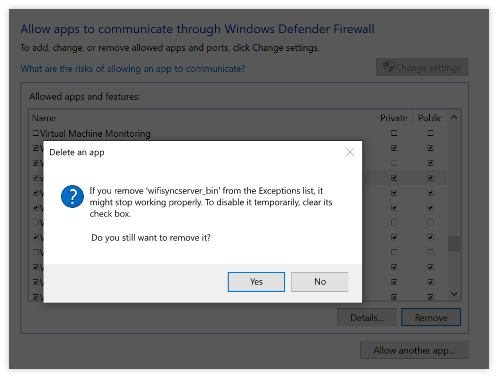

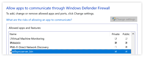

- If Windows had already displayed the Firewall popup and you don’t know which option you selected, follow these instructions to reset the access permission for Enpass Wi-Fi Sync Server.
- Open Windows Device Settings > Control Panel > System and Security > Windows Defender Firewall > Allowed apps.
- Navigate to wifisyncserver_bin.
- Select wifisyncserver_bin and click Remove.
- Now open Enpass and go to app settings > Wi-Fi Sync > Stop Server.
- Restart Enpass and go to app settings > Wi-Fi Sync > Start Server.
- When the Windows Defender Firewall popup is displayed, click the corresponding Private or Public checkbox and ‘Allow Access’.

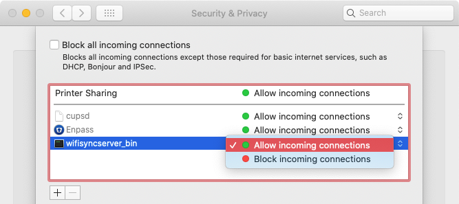

If you’re using the built-in Firewall on your macOS system
To troubleshoot this issue, you need to check your firewall settings and let the Enpass app and Wi-Fi Sync Server communicate over your network.
- Open System Preferences, then click Security & Privacy.
- Click Firewall, then click Firewall Options.
- Allow incoming connections for Enpass and wifisyncserver_bin.

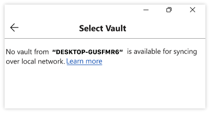

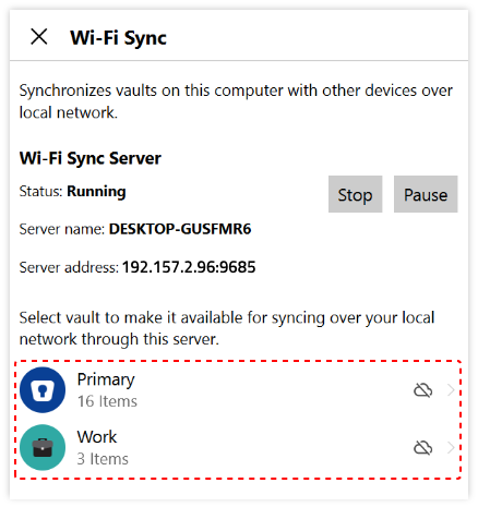

No vault is available for syncing over the local network.

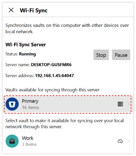

The Wi-Fi Sync server does not serve your vaults automatically over the network. You need to manually add the vaults to server to make them available for syncing. If you have got this error, it means no vault has been added to the Wi-Fi Sync Server.
To add a vault, open the Enpass app on the desktop app running the server, then go to Settings-> Wi-Fi Sync -> Select the vault you want to add to the sync server.
![available vault](/wp-content/uploads/2021/07/available_vault_trouble.png)
![available vault to sync](/wp-content/uploads/2021/07/select_vault_trouble.png)
Once the vault is added, open Enpass on the device where you were getting the error and retry.
